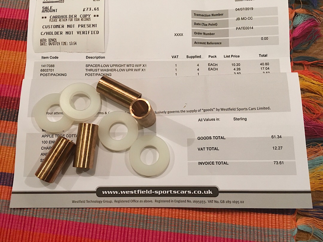

Recall that the Westfield does without the Spridget’s fulcrum pin/cotter pin set-up at the bottom of the kingpin, replacing it with a simple bolt through a phosphor-bronze bush (which is a sliding fit through the lower eye of the kingpin) and a pair of hard plastic washers bracketing it. But after 13 years, the bronze bushing was no longer a “slinging fit”, it being tightly in place. I tried gently drifting it out, but it’s a soft material and it deformed immediately. Work stopped until I could source a replacement from Westfield.
A phone call to the technical chap at Kingswinford and I had the part numbers for both the bushes and the plastic washers. In addition to replacing the knackered offside upright, I’ll eventually do the near side too. It’s absolutely fine, with no play or wear evident. Which always surprises me as the lower grease-nipple has never worked! It’s not the nipple itself; I’ve replaced it, but grease just doesn’t get through to the owner half of the kingpin. So I decided to order bushes and washers to renew both sides. Oh! And a couple of spare bushes too, for the spares drawer. I mean, they’re bushes, right? A couple of quid each.

As ever, click/tap on the photo and it’ll enlarge, allowing you to read Westfield’s comedy pricing! So....... would gold be a suitable, slightly cheaper substitute?

Christ on a bike, a tenner each for a v low volume machine tube might just about be acceptable, but four quid each for a nylon washer? Seems like there are two reamings required to fit a midget upright
Even TVR ones are a quid...! Couldn’t our resident Nylon washer expert (jonners) hook you up?
