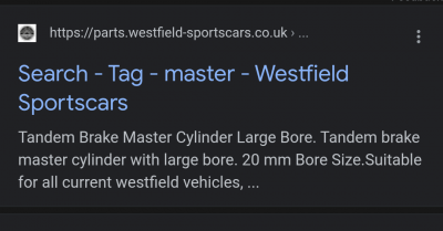

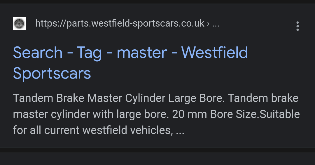

As for it being 'AP', the ref number on the tag (L17B ??BHGL033A) doesn't align with AP part numbers and there is no coloured band on it indicating the bore size so could it be an 'AP style' M/C or perhaps that's the cynic in me speaking!
I'm sure (as I can be) that the air is out of the system, and I've tapped the calipers with a mallet for good measure.
At least I now know that the bore is 20 mm, but £300+ for a new one.......? Would be nice to have remote reservoirs to save digging down past numerous pipes/ cables to reach it in its current position.

Ah ha thank you, I don't think that specific one is sold now but the equivalent may be this one as fitted to Caterhams (if I can upload a screen shot). Being a cheapskate, £365 is a bit on the steep side though for me.
I learnt today that AP Racing and the manufacturer of AP units as provided as standard with the kit are not connected and so may be poles apart in quality.
Having said that I may now have the opportunity to buy a new original kit supplied unit from a fellow builder who has upgraded his system, so I may now be ok fingers crossed.
