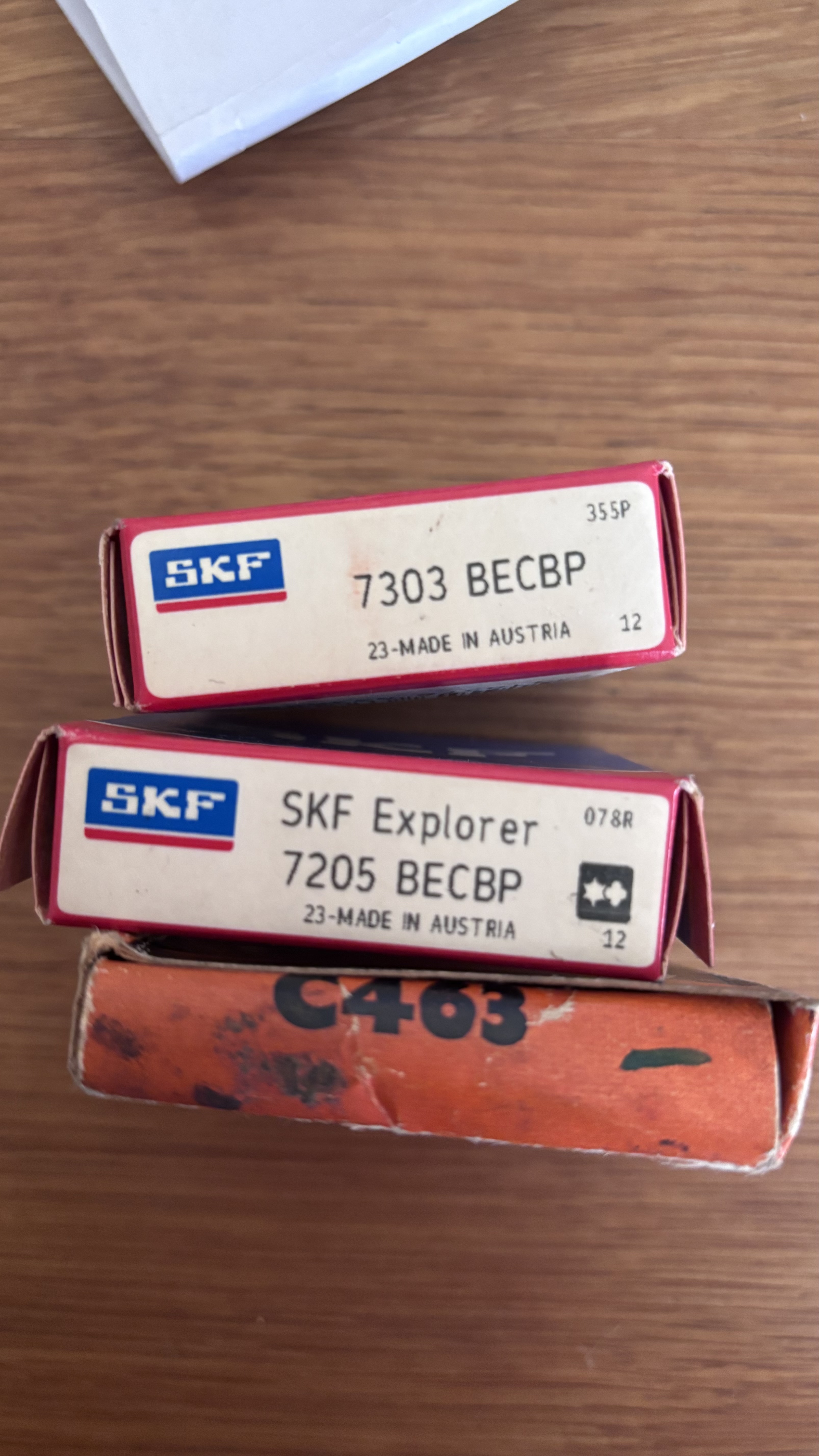

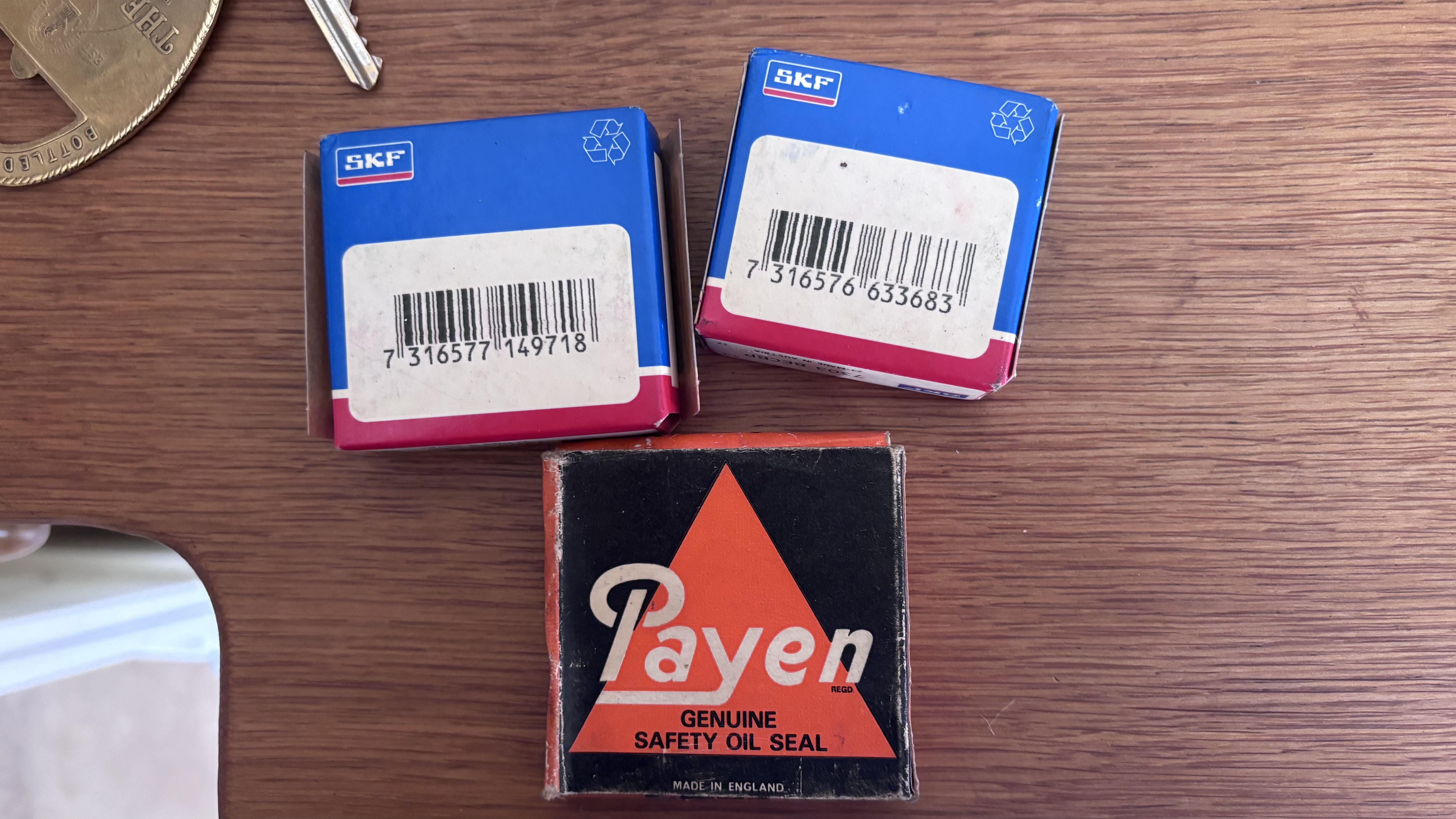

Apologies, but it’s now well over a decade since I did my own extensive research into the front wheel bearings issue! I seem to remember that I discovered that the original bearings were manufactured by a long-defunct Birmingham supplier and had been unavailable for decades.
However, whilst not “exactly” identical, SKF offered a pair of bearings that were very, very close. Following the endorsements of others, these were what I fitted. As I wrote above, they’ve now seen many thousands of miles of running, with absolutely no issues.
These are they (I keep a drawer-full of spares for the car, “just in case”):
Re: Moss taper bearings don't fit
PS if you DO go down the SKF route, then they’re NOT cheap! But do shop around, as prices vary massively.
