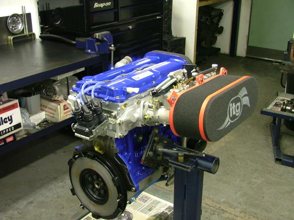

You can get more power from a small 4 cylinder engine. Yes, it may cost more (or not... An SVT ZTec puts out about 230 HP with just webers, and no other mods). The gearbox can be the more common Type 9, and will fit the Westfield T9 chassis. The engine fits on XFlow mounts, so it will fit within the Westy chassis. You will need a bubble, and the Spridget axle will work fine with a set of good axles, double bearings and a TranX/3J LSD.
