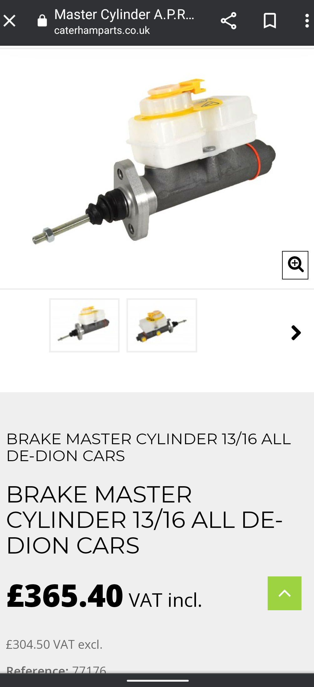

Inconclusive Googling has led me to write to AP Racing requesting the current 13/16” equivalent. Both Caterham and Westfield do a standard MC, which is just under £300. The AP Racing MC has a 60/40 bias designed in, and is factory-shimmed. But, ouch, it’s expensive!
I’m coming to the conclusion that older MC get obsoleted, and, as AP have done, the seal kits become unobtanium too. Depending on the position of the bypass ports in the cylinder, the right “looking” seal kit might not be what you need.
My brakes work, but are lacklustre. I may have to just grit my teeth and shell out.

Re: Bleeding brakes
I dream of fitting a remote reservoir, given the difficulty I have in filling the reservoir in its current position without making a mess.

Re: Bleeding brakes
Could be an option. I have found a MC in stock, but the price is waaaaay out of reach at £538.
https://www.a-pp.com/Categories/Braking ... 27-2PRM100
Some more info culled from various sources for the bots:
After a bit of snooping around today, it turns out I already have a 13/16" or 0.8125 master cylinder. The AP part number on the body is CP3627-101C. The internet doesn't bring up much from this part number. A few threads on Westfield and Marcos forums.
reading through the other forums the body is the CP3627-101C and the complete unit with reservoir is CP4627-2PRM100 . The Marcus forum even points to a stockist. I've sent them an email and will see what comes back.
Picked up one interesting fact which have never twigged before which i'll put down in case someone else finds it useful in future, the ports are marked P & S
P is the prime circuit which is connected to the front
S is the secondary circuit which is connected to the rears.
on pressing the pedal the prime circuit operates first and then after closing a clearance gap the Secondary circuit operates.
